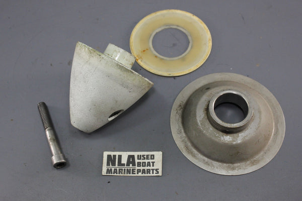

Took my 84 bayliner capri out on the lake and drove up the river Thru the locks and back probably 30 plus miles. Boat has Volvo penta aq125a engine and aq270 outboard. On the way back I noticed the boat bogging down. When I hit the throttle wide open the boat would kind of chug like it wanted to stall. I couldn’t go up past 8mph or it would bog down and act weird. When I got to the dock I noticed that my exhaust flap was missing. I just changed this flap this summer. Rivets popped off I guess. Engine was running the whole time never shut it off . Was not over heating at all. Just got louder on the way back and sounded like it was running rough. Could I have gotten water in the cylinders due to the flap coming off ? What could be the issue? Maybe seaweed stuck inside the prop shaft somewhere ? This was muggy water with lots of algae and seaweed. Not sure what’s going on I’m fairly new to boating. Any help would be appreciated . Could it be bad gas? Gauge was on e but I had just put 12 gallons in it before I went out. I think my gauge is broke. I’m really not sure what the problem could be.

Exhaust flap doesn't matter
Did you service the points?
Set dwell with a meter?

Could be a spun hub in the prop ? Gonna check that tomorrow . Anyone know if the exhaust flap is a necessity on these units ? Worst case scenario if I don’t replace it ?

Is the boat size 19.5 ft ?
If yes then either 28 or 30 gallons.
Re-see post number 2 on the flap... Not totally needed but safer to have it in place in my opinion of boat use.
Maybe something caught up behind the prop...There may be a fishing line cutter installed behind the prop.
