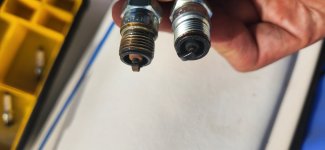

8 plug has blackened insulator and sounds like a knock or ticking from 8 cylinder. See pic attached. Otherwise engine sounds great and fires right up and will idle forever without issue.
My only thought is carbon buildup causing a knocking which is then triggering knock sensor to retard timing and limit WOT? Thoughts?

You might have carbon buildup, likely from oil being burnt in Quantity. You could run a Borescope in to take a look, easier than pulling the Head. I suspect that knock is a Connecting Rod Bearing has gone bad and is what is throwing up the great quantities of Oil, which is overloading the Oil Control Rings

If it was rebuilt 2 years ago, excess carbon should not be an issue at this point. #8 does not look like it is firing as well as the other cylinders. A borescope is a good idea so you can see if there is fluid (oil, water?) in the cylinder.
