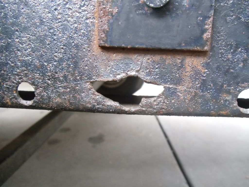

How do i fix a larger than finger size hole in trailer?

im trying to get my boat trailer looking like new again and i was wondering how i could fill a hole that is right on top of my trailers wheel...the hole is a little bigger than a finger and just need some suggestions...

My question is, What made this hole? Is it a drilled hole or a rust hole? If its a drilled hole then the fix is to have it welded ground clean primed and painted, if its a rust hole then the fix is taking the trailer to the scrap yard tomorrow before it loses anymore scrap value.

after i posted this, i was thinking that maybe i should of posted a picture too...the hole is not a rust hole...it looks like a piece of metal broke off, and its not a hole made by a drill...ill post a picture tomorrow morning

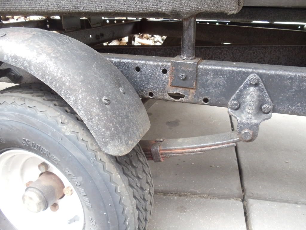

The hole is above the left wheel slightly to the right and its like a triangle shape...kinda weird to explain but ill post a picture tomorrow and then you can let me know if i can save it because im planning on repainting it to look like new again...

you have both rust, and fatigue cracks. have those cracks welded up, or your looking at a busted trailer. what ever was there is no longer there. and from the looks of the witness marks and cracks, it hasnt been there for a while

Do you know if i can just weld them myself or should i get a pro to do it?

I have no way to know your welding abilities or experience, so I can not answer.

Additionally, I would fill all of the other adjacent holes with welds and the other side of the trailer. You may even consider adding some more steel to the inside of the channel to reinforce this area of the trailer.

ok ill just say that i have no welding abilities...but is there something else that i could be able to do instead of welding?

It's probably mild steel which is no great deal to weld if you've done a little welding before. However, it is galvanized, which means you need to grind off the zinc plating in the area you will be welding (or breathe the zinc fumes :( ). You also should grind a "V" into each of the stress cracks before welding them. Then finish with some of that spray galvanizing.

if you have no welding abilities, spend the $50 and have someone who welds for a living take care of it.
the other choice is to let it fail, and scrap the trailer.

No big deal to weld that, but the bunk support will have to be removed as the cracks seem to go up underneath. But if you have no idea how to weld then I suggest taking it to someone who does.
The hole by itself didn't cause the damage. It was what was in the hole to begin with.

can i reinstall the bunk support after welding?

... You may even consider adding some more steel to the inside of the channel to reinforce this area of the trailer.
+1
Adding a backing plate will make the welding easier and add strength.
Remove the Bunk support.
Grind/Power Sand the front and back of the area down to bare metal.
Weld it up (you or someone else).
Clean it up with a light grinding, and spray it with Cold Galvanizing Compound.
Remount the bunk support.
Go boating!
