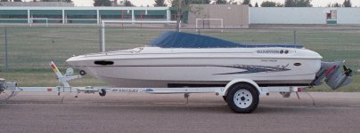

If you look closely, you can see the strap on mine is almost horizontal, I like this pivoting winch bumper design, never have had a problem with it as long as it's adjusted to the correct height.

When I took delivery of my Boat the Trailer was set up this way, it was to be reconfigured
The way I had them adjust it. Move the Boat, and Bunks forward which required the Axle to be relocated too. Had Supports for the Front of the Bunks added. Had them swap the Trailer Tongue end for end which then placed the Swing Hinge right under the top of the Winch Stand. Had them reconfigure the Geometry of the Winch Stand.
jimmbo
May 24, 2004
14,142
The Winch Strap, even though it is Twisted is Exiting at a good Angle, mainly because it is unwinding from the Bottom of the Winch Reel. However that is not how the Previous Photo had it. There it appeared to be unwinding from the Top. From this Angle, the Boat appears to be against the Bow Stop.
You do have 2 adjustments available, Height of Winch Stand and Fore/Aft Location. Adjusting Height will require repositioning the Stand on the Tongue

That’s a good catch on the strap angle. It does appear routed differently than the picture in the first post.
Since it hasn’t been an issue until now, I don’t know I would make any adjustments. The original post says he was in a hurry. He didn’t say if it was the ramp he normally uses or not. It could be that there is no real problem to fix and this was simply a one time occurrence. The original question was how to get it against the stop.

Safety chain should go down to the tongue and have only enough play to get it attached. In case of an emergency stop you don't want the bow to climb up over the bow stop !

From an older photo, boat loaded all the way forward.
So what do I need to fix so it's not "all wrong"?
Rewind the strap around the drum so it comes off the bottom. Worry about getting it against the stop next time you launch, unless you plan on doing a long drive in its current position.

I agree but it seems like all safety chains/cables come attached to the winch post.
Probably from quick assembly from the factory. In every boat trailer I have owned ( probably 2 dozen or more) and having worked at a marina/ boat dealer, every trailer I have saw has the safety chain pulling down toward the tongue....this also.makes them much easier to attach with little play. Your boat, use as you wish, but think about the geometry and what the chain needs to do in case of an emergency.
I see a lot of bass boats where the safety is just another length of strap stitched onto the winch strap.

I'll rewind the strap so it's again coming off the bottom of the winch.
