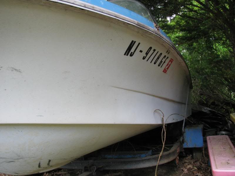

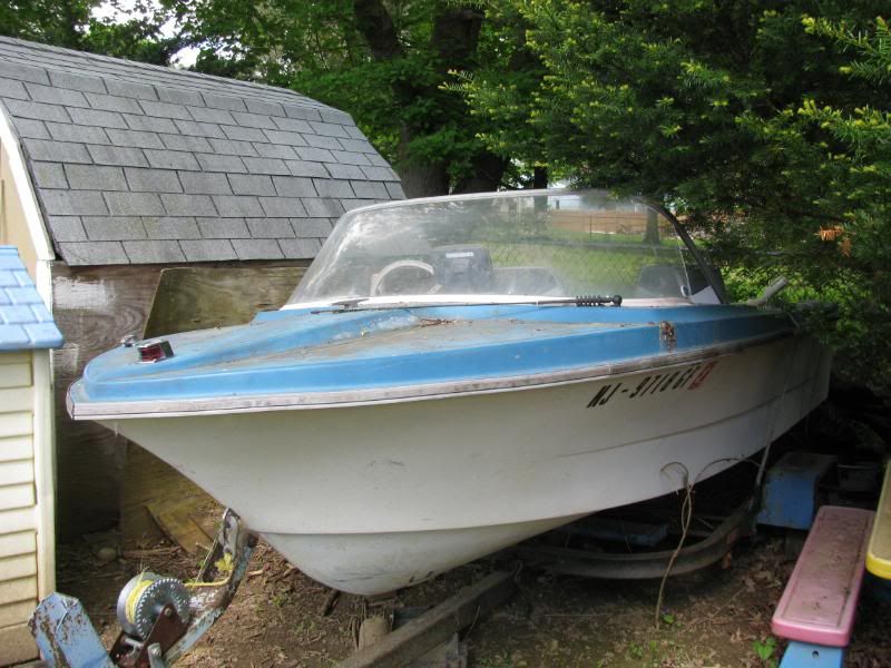

So this MFG Carefree was full of water when I found it-the plan is to gut it and glass in new stringers, new transom, etc...so how do I get the top off?
I should have gotten closeups, but you can make out the flange where the top meets the hull here-no bolts or screws that I can see, just glass. Does this mean I actually have cut the top off?
On the inside where the top meets the hull there appears to be some kind of spray foam-for flotation I guess? Do I just cut that out too? My next question has to do with the deck. The interior deck is all fiberglass and will deflect a bit when I press hard with my foot, which I'm assuming its not supposed to do, so that would mean that there are structural issues underneath? First, what is under the glass deck? Plywood decking then wood stringers underneath that? Will I have to cut the glass decking out or does that come out when I separate the "top?" (the part that covers the bow and the rails, etc-what is the proper term for that?). My primary goal for this summer is to get the boat apart and remove all of the rotted wood, which I'm sure there's plenty of. I have a dry place to keep it for the winter, so as long as I'm in a position where I can start glassing next spring I'll be happy. I did read that some MFG's were all glass, but I doubt I'm that lucky ;) If all of you could take pity on my lack of experience here I'd appreciate it. I don't know a lot about boats yet but I'm learning-I'm a pretty hardcore DIYer who has tackled everything from complete home remodeling to engine rebuilds with a pretty high degree of success, so with some good how to information I'm confident that I can do this.

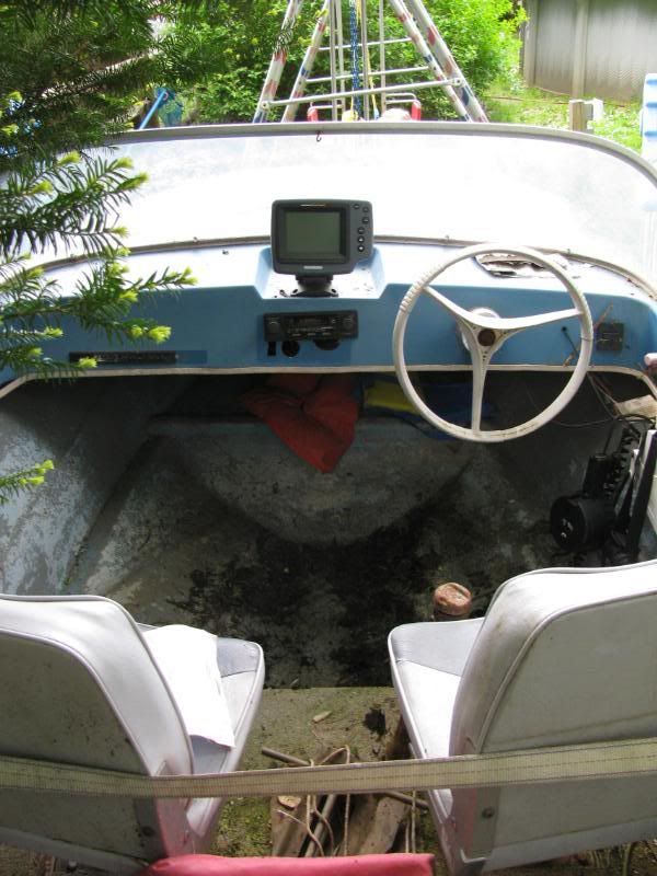

Can you send pics of the deck and the transom? Seperating the cap may not be necessary. Is that upper foam dry?

The upper foam is bone dry-I'm assuming that's good? I don't have the greatest pics of either the deck or the transom, but these give you some idea:
Deck:
It looks as though the deck was originally blue like the top cap, but it was painted grey at some point-the grey is peeling as you can see.

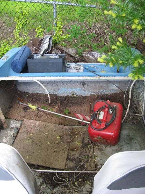

Transom cap:
(I haven't been able to get behind it for a pic-it's up against a fence)
It would be great if I didn't have to take the cap off and could just get to everything by tearing out the floor/transom.

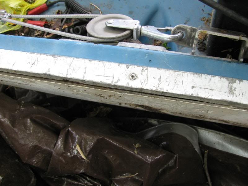

Why did you start another thread?? This will make it very hard for everyone to keep up with your project. The RubRail(Flange) does it not have a removable rubber insert? It appears from your pics that something is removable from it. There will be rivets, screws or staples behind the insert. Try to keep your posts all together.

I thought it would be less annoying to people than bumping my own thread, but I see what you mean. As for the rub rail I think that the rubber/metal trim piece around the outer edge is what you're referring to? I guess I could pull that off and see what's under it. I think I may try to avoid taking the top cap off anyway-we'll see.

Yes, remove the rubber piece and that is Where the joint is. Like I said it will be either screws, rivets or staples. Hopefully NOT staples.
Looking at the splashwell on your boat, I do not think it will be possible for you to replace the transom with the top cap on the boat. If you can take some pics of the transom from up under the splashwell I could give you more information. Especially in the corners of the transom.

So whatever is holding the top cap on (staples, screws, bolts, etc...) can be found by pulling off the rub rail? I've heard this is expensive and that if you can save it you should-what is the best way to get it off? Should I just slowly work it loose with a pry bar? Then will it just be a matter of getting the fasteners out and the top comes off or will I have to grind away some glass too?

Is there a rubber insert in the rubrail? If so, remove it and then take a close up picture of what is behind the rubber insert and post the pic so we can see whatcha got. Based on the pics you have posted so far I am inclined to think your topcap is attacted to the hull with stales but I need a closer look at your rubrail and how it's attached.;)

I think so-if you look at the first picture I posted you can sort of see it. It looks like a metal strip with a black rubber insert in the middle. If I indeed have staples I'm assuming that's bad? Is that just because they're a PITA to pull out with wrecking the hull/top cap?

Yep, and the rubrail metal piece is sometimes a PITA to remove. Get some close up pics please.
