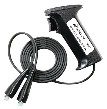

Grub54891
Jun 17, 2012
6,428
I use one like this. Any parts store has them.
Image result for remote start tester
