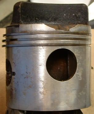

Here's a shot of one of the pistons. A little dirty from sitting around my garage for a year, but otherwise in almost new condition.<br />
