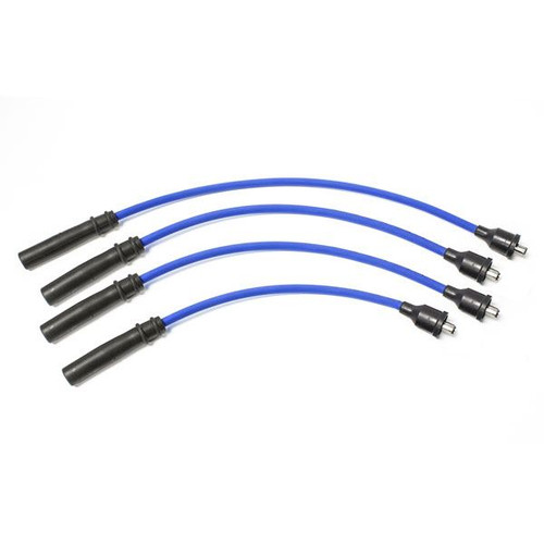

I have a Mercury outboard (1F75412CD) and I accidentally broke the wire. The metal tip at the end connection to the ignition coil fell off and I tried to getting it back on but it did not work and the boat made no noise when i was trying to start it.. I am trying to find a replacement preferably by this weekend.
The OEM part number is 804272A1, I went to autozone and advance auto parts but neither of them were able to help me. I can't find a version of the oem wire. I found this: https://www.amazon.com/dp/B000S2SRXC which i thought might work but i'm not too sure.
Are there any recommendations on what to do here? How I can find one.
I'd be open to making my own if i could find everything i need in time if it would be best
