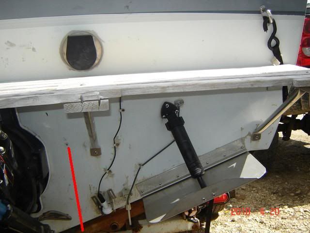

With all the obstructions on that transom, unless you are willing to put some bow eyes below the swim platform (well sealed of course, probably below waterline), and weld some eyes onto the trailer, so that the straps can be like the red line I added to this pic:
I see no reasonable solution except an over-the-top ratcheting strap.
Maybe do both?
