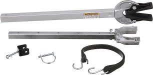

btw, you can get the bracket that goes on the trailer that allowes the transom saver to move up or down.

I just put all the motor weight on the transom saver as not to stress the transom at all. you will know more about your application than me. jmo

Don't need a transom saver if you have plenty of clearance to tow with it down. If you have to tow with the engine tilted up (for clearance) then use a TS.

The picture shows us nothing became it is at the wrong angle. You need at least 8" of road clearance. If not, get a transom saver. If yes, follow post #10. Regardless, get rid of that nasty green strap.
When it’s sitting in the lowest tilt lock setting like in the pic it has 13 inches of clearance. Green strap is just stop motor from moving side to side. So now I’m really confused 🫤… so your saying if the motor can’t sit all the way down and be vertical and have over 8in clearance then I need a saver or take motor off when towing? But wouldnt putting a saver on only help support the tilt bracket and not the transom? Since if I put the motor how it is in pic it would be exactly the same angle as saver. Or am I not understanding how the saver balances the weight of the motor? Thanks I appreciate it. I know I sound dumb and well when it comes to boats I am and trying to learn the correct way so thanks for all y’all help

after looking at the pic, i don't know how your going to put a transom saver on there, but i will ask, isn't the license plate supposed to be under a light?
