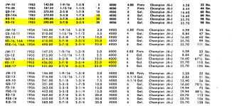

this is the best book to service your oldy for 20$ you can download a copy of 400+ pages of the johnson manual cousin of evinrude.
covers magneto carbs GC timing etc..
just print locally and spring bound with plastic cover sheet front and back
it contains all the info you you need under the johnson RD series
