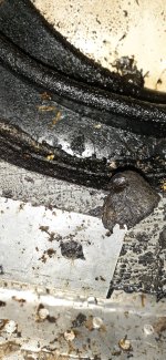

Took the boat back to the lake and backed the trailer in until we had a leak.
The leak is coming out the end of a straight metal piece with screws mounted to the stern , left of the motor. It is very gummy/black on the end of the piece closest to the motor.
Grub54891
Jun 17, 2012
6,425
That sounds like the transom boot/seal. A pic would verify. Easy repair if that's it.
usmacs
Jul 20, 2011
17
The water appeared to be streaming from the right side of that metal piece below the transom seal.

52,146
suggest you buy a new boot
remove the drive and do a drive service
with the drive off, remove the old boot and inspect the transom
if the transom is good, replace the boot
re-install the drive
go to www.sterndrive.info for videos on removing the drive
be very very very carefull with the shift cable. that little beauty is now $950

Took off the speedometer. Put a hose to the holes. Water poured in at the same spot as it did when we took it to the lake. Removed, glued and rescrewed speedometer. Will test with hose and lake. Hoping this will be the answer. Thank you for your responses.
usmacs
Jul 20, 2011
17
Took it back to the lake. No leak from speedometer so continued to lower into lake. Water poured in from bottom of transom seal. So... is this something we can do ourselves....
52,146
yes, see post #29
