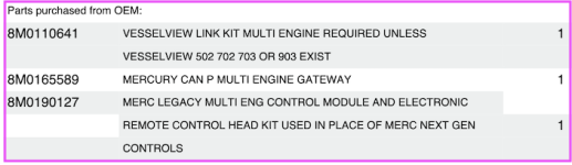

When I do the Optimus 360 configuration using their website tool (optimusbom.com) I get some notices when configuring for Mercury engines.
Apparently, the Optimus does not work with the latest DTS controls, so I'd have to buy a legacy control.
Then there are some Mercury parts to get to make it all work, which could add about $4K.
The Suzuki and Yamaha configurations come up cleaner.
