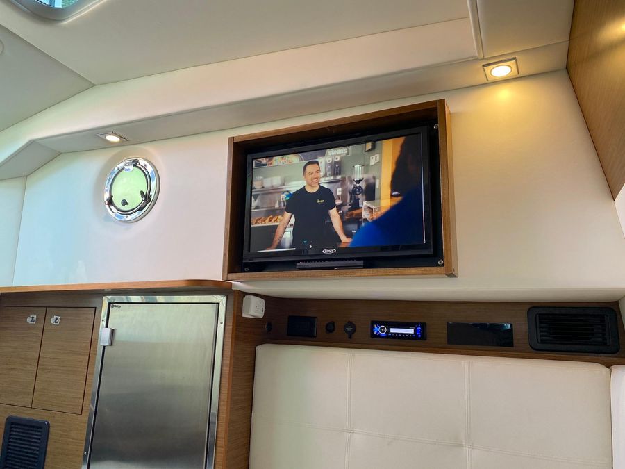

I've listed my CY 338 for sale in a couple of places . . . Still got to do a couple repairs. As a final improvement project, I installed the TV that I had sitting in the closet for the past 3 years. :ROFLMAO:
