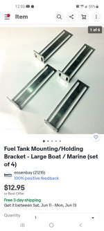

Thinking of trying these. The rear one ill bend sit flush on tank bracket.

Of all the researching I have read... screw holes in deck tend to allow water thru floor and then comes rot. What I did was glass extra wood to top of deck and screw to that. Put a lot of effort into a solid rehab and didn't want to ruin it a few years out..... for what its worth

Those tanks have screw flanges, or so it looks. Why not glass a piece of wood to the gunwale and screw the tank into it? Alternatively, there are lots of straps for fuel tanks. Those could be screwed to the glassed on wood and wrapped around the tank.
