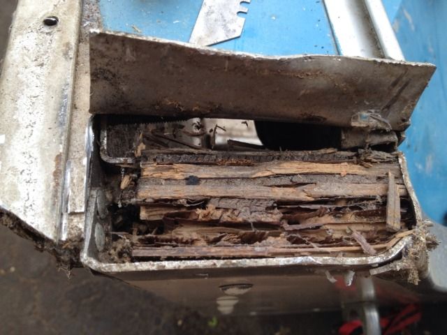

Drill out the rivets holding the end caps on at both ends of the gunwales. Check how much coverage they give you to confirm you can cut 1.625" (1 5/8ths) +/- off the end of the gunwale's tin. You might be able to bend it up out of the way, but it will probably crease the metal & that crease will likely remain when you try to bend it back.
I'm with you all the way, but trying to figure out the exact location you are removing the 1.625 off of. Any chance you could send me a pic of that?
I will send pics of her rear end tomorrow if that helps.. (me)
Uber thanks.

He might be talking about this
I drilled out my transom brackets and used a dremel with a cutoff wheel. I replaced the transom wood and just pounded the metal back down. The cap covered and no crease(where i bent it back) showed.

Yep, Bonair's got it
But here's the before:

Just take a pencil and trace the shape of the cap before you drill it out/off...then you'll know how far you can cut/bend.

Very nice, makes more sense now. thank you (picture is worth 999 words, the last one is left for my wife)
