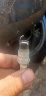

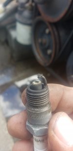

Ended up being the same issue, made it out no problem. Anchored up spent 4 hours on the island, loaded up and left. Less than two minutes into the trip back the engine quit. Came in on the kicker again. Everything that happened before, happened again. Got it home and it starts right up. Took it out last weekend to try and replicate. It did! This time im ready with tools in hand. Pulled spark arrestor it's getting fuel. Started pulling plugs. Starboard side looked good. Pulled the #1 port side completely burned up. Pulled #3 port side it's even worse. #5 the ceramic housing cracked while removing but the plug looked ok on the inside. What brand would anyone recommend? I've always used champion, but at this point maybe reconsidering? Anyways, This leads me to believe the port side exhaust manifold it's clogged causing it to run hot. And my temp sensor is no good. I pulled all the drains and ran the hose to it. Fired it up and sure enough nothings coming from the port side manifold. I tried pushing some compressed air through the inlet side, no luck. Went up from the drain, bingo, blew out nasty rusty water. Hooked it back up and ran it for fifteen minutes. At this point I'm seeing that my temp gauge isn't working at all. Everything appears to be flowing though. I tested the sensor, is indeed bad. When I ground the wire it pegs the gauge. Pulled the sensor. I just need to get my hands on another sensor to ensure my temps are dialed in. Anyone know a part number on that sensor? I googled it and everything is showing the part with a 3/8 opening I'm fairly certain it's much larger. (Came off with a 23mm socket!) Lou im definitely looking into a complete exhaust conversion after seeing the condition of those manifolds! At this point I just want to ensure that everything else is in working order, run it through the paces and then get the exhaust parts orders and swapped over. Will I need to pull the motor to do that conversion? It didn't appear I had to, but you would be the expert.

Those plugs are trashed. I would check the base timing and total timing advance to make sure it’s not too far advanced. Base is 6*, max centrifugal advance is 12* for a total of 18* at approx 3200-3500 rpm. From my OMC manual. Use AC Delco Marine MR43T plugs.
