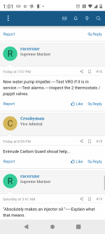

Not sure why this was mentioned in post #17.----The statement does not make sense to me.
38,744
I see post #17----I am not sure why the comment about---" Absolutely makes an injector oil " ----is even in that post.-----I am just curious as to what is meant by that comment
saltchuckmatt
Jul 19, 2019
2,823
Here is what I see....not sure who your addressing but it wasn't me.
So some can see it, other can't?
tphoyt
Jun 10, 2010
1,517
I recall seeing that post but i can’t see anymore.
I assumed it was a spelling error as I also recall seeing an Amsoil bottle that said injector oil on the label but i have no clue what makes it different.
flyingscott
Apr 8, 2014
8,195
I am sorry about post 17. I made a mistake. Are you guys going to live or should I start a post on it? Seems to be taking over the thread. Let me know if I should start a post?
38,744
Start another --" oil thread "----On the fundamental difference between TCW oils and oil meant for direct injection engines ?
