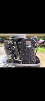

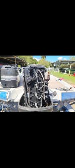

Its a 125 y dont know for sure It Is 2+2 It was mentioned here by someone, but Im not sure of that
redneck joe
Mar 18, 2009
14,456
From my limited knowledge that refers to a powehead that is essentially two powerheads of two cylinders each. My 1982 50 is like that, two twenty hp stuck together with some other changes to get to 50hp
lgaytan
Jul 15, 2015
206

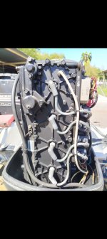

Not yet, next week I'll go again to do the compression test with the spark plugs socket, but I think this engine looks very clean I'm positive about it.
Texasmark
Dec 20, 2005
14,936
By the way this is the first time I drive a 2+2 motor, it was very noticeable a kick when power hitted of the 4 cylinders working it is not an smooth acceleration as i have with my old 50 hp, Is this a normal thing?
Your old 50 had all the cylinders active all the time. Not so with this engine.
The lower cylinders get a little fuel to keep the lube up but not enough to light off. As the throttle is increased, the fuel pressure from the fuel pump increases and that increase if felt by a couple of pressure regulated valves in the fuel line to 3 and 4. If you advance the throttle slowly above about 2000 RPM you will feel one kick in and then the other kind of intermittently until they are on line.
. The activator for those cylinders holds fuel waiting for the pressure to get high enough to cause decent flow as mentioned above.
If you hammer down on the throttle, the cam that forces fuel out of that chamber causes the fuel to "squirt out" and you get immediate activation of both lower cylinders and you will feel the power surge.
