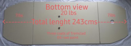

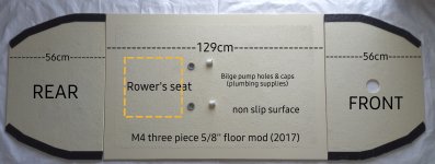

Thanks to everyone throughout the years who have shared with us their great tips & ideas on how to modify our M4's. I'd like to share a few pictures of my 3 piece 5/8'' plywood non-slip painted floors. I've been using these for a few years now and they work well for me. I weigh 240lbs and they are very sturdy. After a day of fly fishing on the Bow river, the boards are easily rinsed off and they dry quickly.
May you all have a safe boating season.
Enjoy.

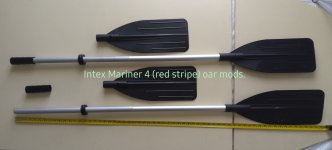

Oar mods: One solid piece
Inspired by posts from Starkonian and 300winmag, I decided to ditch the flimsy plastic oar connectors and make one piece solid oars. I wanted to increase the length of the oars from 54'' to 60'', so I replaced each of the shorter sections with a longer piece on each shaft, from old Intex oars I just happened to have hanging around. This completed project only added 1lb to each oar which is noticeable but not too bad.
Picked up two 1''x 48'' wooden dowels from the hardware store and cut them to fit the entire length of the shafts about 42''. The interior dimensions of the aluminum oar shaft is approximately 1.13'' leaving a small gap. I used 3M 5200 Fast Cure* permanent marine adhesive (3oz tube) which is flexible and waterproof and it expanded enough to fill the space. I wrapped the aluminum shafts entirely with painters' tape, and covered the floor with a drop cloth to make it easier to clean up the oars afterward. I dampened the dowel with water prior to applying the adhesive. I found the applicator nozzle that comes with this adhesive useless for this project.
*Be sure to read and follow the manufacturers instructions prior to using.
While wearing nitrile gloves, I used a small shop towel to apply small amounts of adhesive on each dowel and rubbed it all over the damp birch dowel. When complete, I slid them inside the Intex oar shafts and slapped on the end cap. In order to slide the oar shafts through the oarlocks, I did not glue the hand grips on as they have to be removed. This adhesive requires humidity to cure, so to ensure the oars cured properly, I wrapped them up in a damp towel and left them inside the house for a couple of days.
Those of you who have worked with this product know how much of a pain it is to apply. It has a mind of it's own and wants to stick to everything like a heated marshmallow. Though I'm very pleased with the outcome, I don't recommended using 3M 5200 Fast Cure if you're not familiar with it. Take my word for it, the product is messy and you may find yourself wishing you had used something else such as epoxy which dries faster. Be sure not to get this stuff on your hands or you'll never get it off. I would strongly recommend you have an adult assistant, wearing gloves to help squeeze out small amounts of the 3M 5200 Fast Cure straight out of the tube as you go along.
My oars shafts are now rock solid, but I always carry spare set of oar blades and oarlocks just in case the extra length causes stress.
