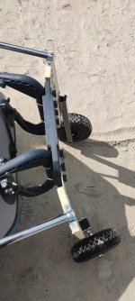

Jan 29, 2024
2
Turns out the metal connecting plates where not thick enough, and started to bend upon mounting the wheels and lifting the boat and starting to roll them (picture below). Have to improvise.
