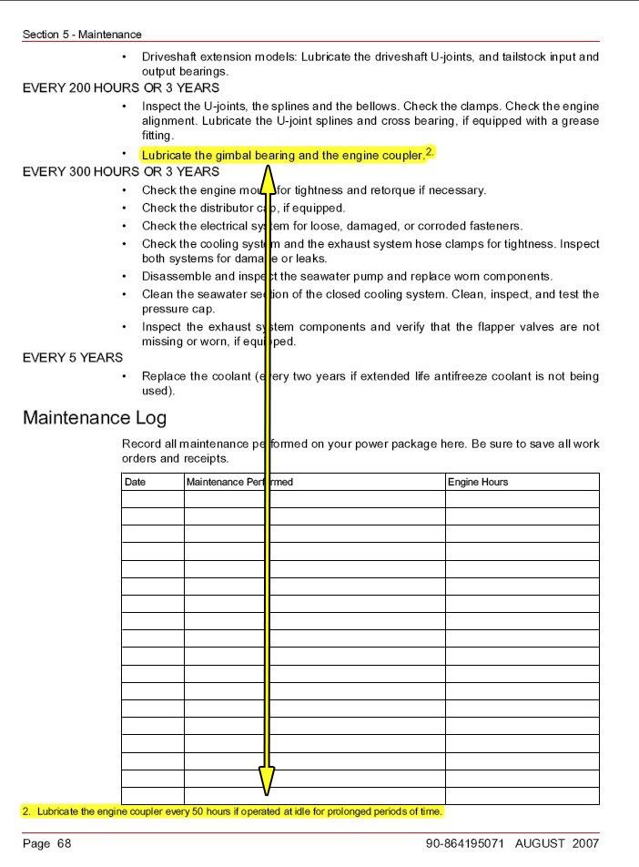

cyclops2
Banned
Apr 19, 2011
1,237
Re: Is running at low RPMs for a long time "bad" for the engine
I keep receiving." You do not have access to this page ". Posting a picture.
From the Manual...
Note: If the boat is operated at idle for prolonged periods of time, coupler should be lubricated...BRAVO MODELS - every 50 hours; ALPHA MODELS - every 150hours.
It is on page 29 of 56 pages,
Frpm www.mercurymarine.com
Don
I just noticed my quote is also in section 5 Maintenance . Talk about the inconsistancies ??
cyclops2
Banned
Apr 19, 2011
1,237
My documents look like a legal PDF. The responsibilities of a owner & a dealer are spelled out. Even including D I Y maint. Suggestions.
It looks like a document # of... 90-899883179-Maint.pdf
Could you check it out ?
