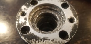

Is this trim end cap usable?

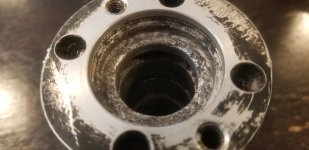

Can I still use this trim cylinder end cap? I scraped out as much salt as I could with a pic and wire brush. It's not smooth where the scraper will sit.

Idk, I bought an SEI replacement for $160 and am very happy FWIW.

EDIT: It's metal on metal so it seems like a little pitting wouldn't matter regarding leaks? Also the scraper has lots of play inside the end cap, not even close to a tight fit but it fits extremely tight on the piston. It's the right rebuild kit so I guess that's normal?? It extremely tight on the piston

I'm replacing the seals (o rings) in the cap. Not sure if the pitting shown matters
I’d try and get the surface where the last last washer sits a bit cleaner. Emory paper? and be sure the channel where the final c clip that holds the washer in place is clean. Since the seals are inside the cap you should be good to go. Good luck

I rebuilt 4 of mine. Similar corrosion as yours. I had to replace one cap at about 50 bucks. Only because I had to heat and beat it out of ram tube. I made my own spanner wrench after seeing what MC wanted for a new one. . If my memory is correct, the scrapper and seals were inside of cap and that part of the aluminum was not bad. I put them all back on OD and so far, no leaks.
