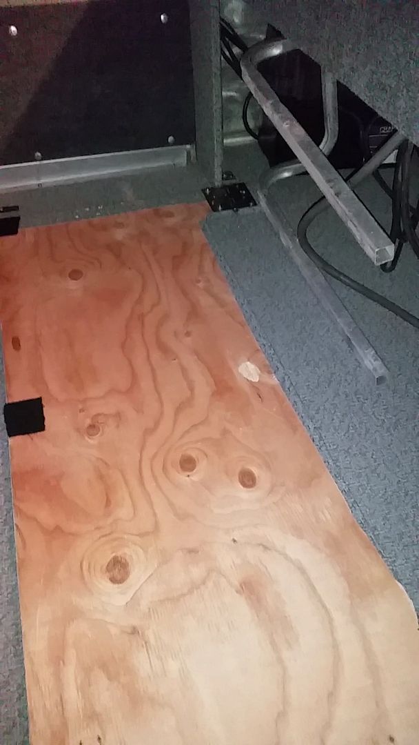

Did a little figuring on how to close up the space under the splashwell.
Came up with an idea where the "door" hinges down, allowing for easy access to the bulge, battery and fuel loading.
There will be a cushioned "bench" along the splashwell ledge with a lip to hold the door closed. It will be hinged at the back. I will add some support to it so it can be used to rest a seat if I want.
The hinges I have are 1/2" too big, so it haven't yet secured it. I haven't built the bench closure yet either lol.
The cut out along the bottom is for ventilation and for my feet, I noticed while fishing out the back, my feet are under the splashwell.

Interesting design Rob, so it will swing down to open?
yes, it will swing down to lay flat on the floor, that will allow me to slide fuel tanks and battery in and out easily I think.
The hinge will need to be on the side of the plywood facing the helm, on top of the carpet. Else when you lay the door down, the hinge will be bound and stressed. Esp if kneeling on it or putting fuel in thru the opening.
Otherwise, I like the look of the panel, the toe cutout is a great idea, and generally this also fits the rest of the great work you've done so far.

Just remember those portable fuel tanks all vent fumes to the atmosphere and it's now a compartment even with the opening at the bottom there's no exit for the ventilation, in other words it would be a pressure bubble not allowing much for air movement. Think about adding a vent grate to the upper center of the door so the compartment can vent fumes.
Another idea for you as far as securing that back cover piece. You're going to have some latches on both sides near the top I'm thinking? So rather than hinges make the piece removable by using a piece of AL channel at the bottom that the entire length of the piece can rest in securing it from movement. Then you un-latch, lift up the piece and remove it off to the side so you don't have it in the way. Anyway that's what I did with my Chief's back cover if you need I can get some pics later and post them for you to see how it looks.

thank you! My plan is to reverse mount the hinge stern side of the door, affixed to a block or 5/8 ply, same as the hatch before screwing to the floor. That will keep the hinges on the same plane and eliminate any binding. I hope lol
I agree you need to keep coming by the forum adding your experience to others builds and get in the running for the 2015 SOTY award.
I have been thinking about ventilation, in the center of my splashwell is a 3 or 4" hole for the electric cables and fuel line to run through to reach the motor. I will not put a boot on it like I did the hole for the steering and throttle cables. I edged it with wire loom to protect the cables and finish the look. Do you think that hole combined with the door/hatch slot air flow will vent any fumes out the top?

Very clean looking. Nice way to hide the battery and fuell tanks. I believe the center opening in the splashwell will work fine to vent any fuel vapors out.
