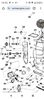

I double checked the parts-explosion pic online, and I'm now seeing that the seal (#26 in the pic, a rubber covered metal washer) seems to be installed "between" the cylinder head, gasket, and the block!
Can someone please confirm or deny this?
If this isn't the case, the original seals could've easily fallen down into the water jacket when removing the thermostats, and could be providing restriction of water flow causing my intermittent overheating...
I have a full engine gasket kit on hand, and can easily pull the heads and rectify this, should this be the case..

The orientation is a no brainer on this....shows it clearly in the parts breakdown. Is this a saltwater motor. Somewhere you have restricted water flow.

Turns out I was partially right. Those rubber coated metal gaskets do in fact go between the cylinder head and the block, and upon further inspection I can now see and feel the originals in place. I had been running it with a second set mounted on the thermostats themselves (dummy lol), thinking they were missing.
After cleaning all the old hardened grease out of the orifices and threads (and removing the second unnecessary set of gaskets), I've put a fresh light coating of Yamalube marine grease on the narrow end of the plastic thermostat housing (that goes into the head through the rubber coated gaskets) and the O-rings on the large plastic nuts, and buttoned it all back together.
