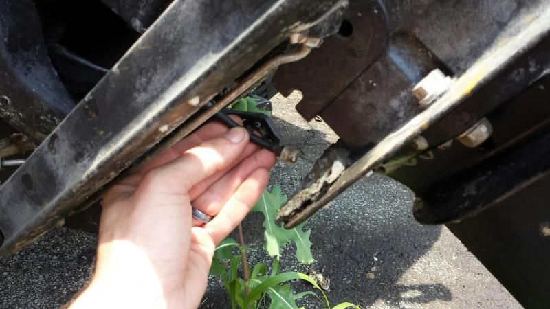

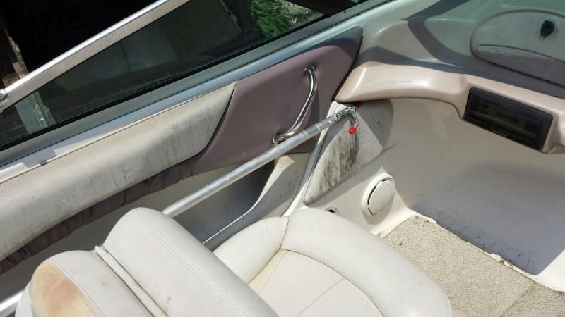

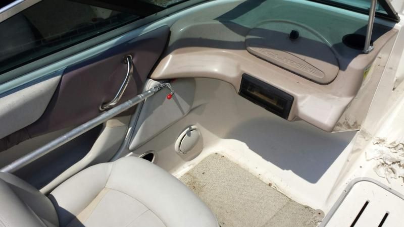

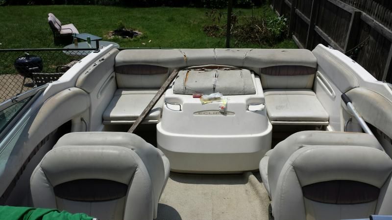

got it home today, did some quick interior cleaning. ive got all the parts on the way to do the gimble bearing and bellows. its probably gonna get an interior this winter. some questions, the bimini top is there, but there are no bolts to screw it to the mounts, what are they supposed to look like? for the bilge pump, when i have the dash switch turned on that just activates it so when the water gets to a certain level it will turn on and pump correct? or is the switch supposed to make it run all the time? also the engine cover has a piece of wood to keep it up, is there supposed to be some sort of strut or something bolted to it??

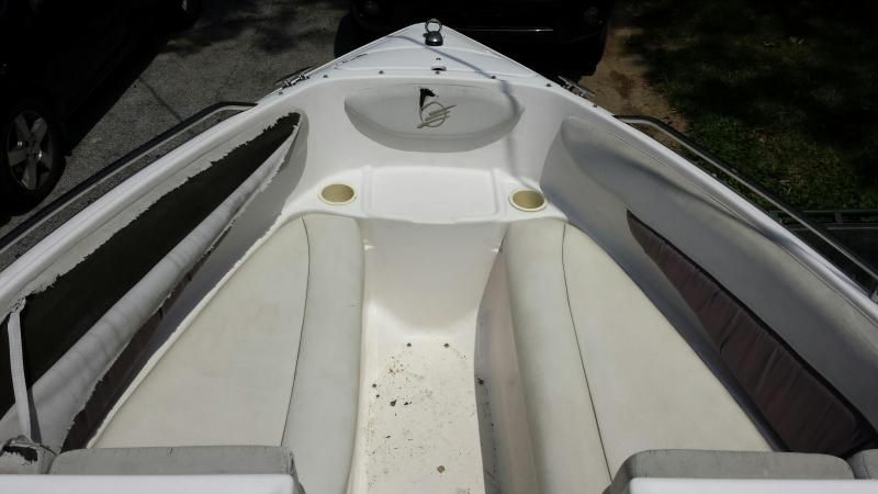

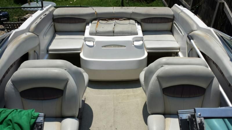

here are some pics of it. 1997 wellcraft eclipse 2000s
on the way home this morning
some interior before and after. all ive done is just wipe it down so when people come over it looks slightly presentable,

The screws should look something like this

The other question I can help you with is the bilge, put your plug in, put the hose in the bilge and turn it on. The bilge should be automatic, so make sure it is by doing this, do it the first time you go out every season and a even a few times through the season. The switch should be for just in case, say you want to check how much water you have on board, otherwise the bilge should not depend on you using the switch to clear any water it should do it on its own.
Also, the wood is a go around, it is possible you could have had struts but to be honest I have seen them both ways, on yours I bet it did not, I would think that the amount of work you are in for the best idea would be to remove the hinge so that you can remove the engine cover completely, it will just be easier on you, then once your done with the interior you can fabricate mounts for a couple struts to make it better, completely depends on you.
Your outdrive needs new anodes, the line you see could be the speedometer but I am guessing, the part that impresses me is that what needs cleaning appears to clean up nicely! If you need to take the carpet out completely and wash it with a power washer, probably be a good idea to judge its condition, if it is to brittle take it out and leave it out until you are ready to replace it, then take it to your upholstery guy so he has a pattern it will save time.

The bimini could be also one of these:

i actually went out and found the hood struts undone hanging down by the engine, so i guess i can look up some replacements. also thanks for the link to the hardware, that looks like exactly what i need, and west marine should have them in stock down the street. it has a closed loop cooling system on it, and one of the coolant hoses is rubbing the back of the alternator, looks like its only a matter of time untill it pops, im gonna have to look into a new hose as well

Good luck with the boat! You can get replacement prop rods from Napa.

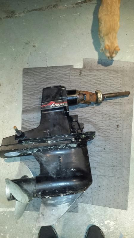

got the outdrive off, bearing came out with it, oil in the u joint boot. what seal is bad letting oil in the bellow, is it on the transom side or outdrive side??
