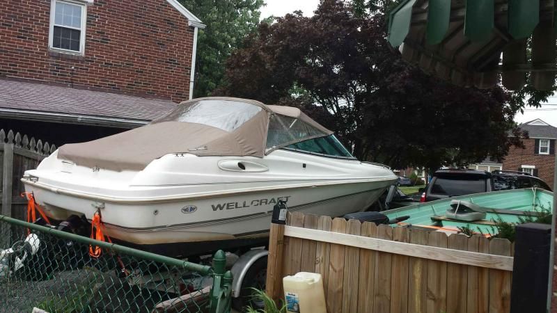

the PO said the cover was ripped so he took it off.......only the front section that covers the bow is ripped, the whole back half is perfect. so i put it back on to offer as much protection as i can

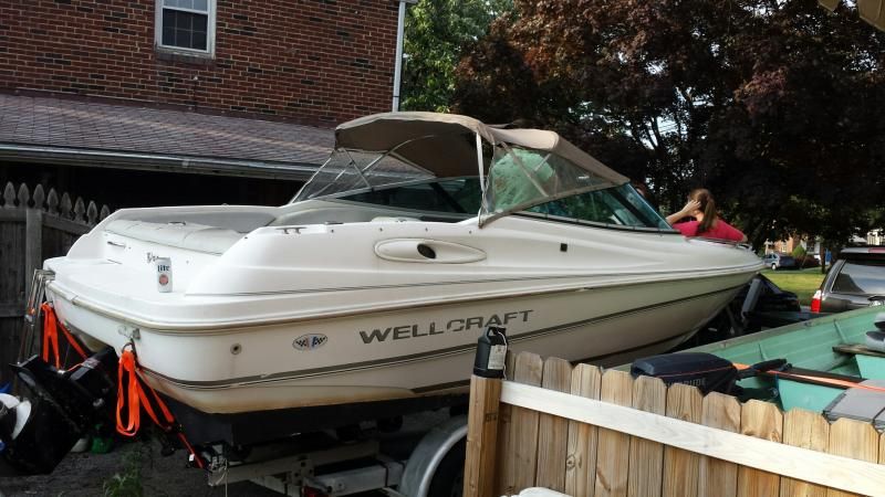

and last night my wife was showing her sister and friend the boat.... which somehow turned into a boat party in the driveway, and i **** you not, they ordered pizza and had it delivered to the boat.....
