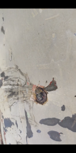

I have a few rivets that leak a little bit but one that drips pretty consistently. I tried placing two part marine epoxy on it after cleaning and sanding the rivet but to no avail. It still leaks. Any advice? Im a little worried to take my boat out if it's actively leaking. I have a pump btw.
Thanks

From the pic it looks like some aluminum is missing. You might need a small patch over that area. If no material is missing, try some " goop" over the area, I have had good sucess with this stuff.

Correct fix is replace the leaking rivets with new solid rivets.
Short term fix is put a blind rivet in there covered in goop or some other sealant. Then keep an eye on it. Wont be as structurally strong but should stop the leaks.

I wouldnt use flexseal, bedliner, or a 2-part epoxy for a temporary blind rivet fix. 5200 is your best bet and you will need it anyway in the future for a proper fix. Goop works but comes off easier and is a one-part sealant.
Just remember that solid rivets are structural, so using a blind one in place of a solid places more stress on the other rivets. I ran my boat with a bunch of temporary blind rivets plus sealant for a summer before its restoration.
But I probably ended up taking out even more rivets from the added stress. One day a rivet lost its head and the tail went into the boat. That little hole filled my boat up over the floor boards with water before I noticed I was sinking. Luckily I have an 800 gph bilge pump and was able to get back to the dock fast. Lesson learned. If you’re worried about being on the water at all from leaking rivets, then fix them properly cause if they break out, water comes in fast.

Well I wasn't worried until that story. I read that lots of older boat have little leaks but I sure don't want to pop a rivet! I'll have to really patch this up. There is no accessing it unless I tear apart the floorboards.
