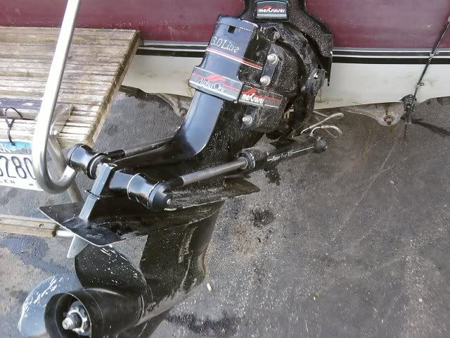

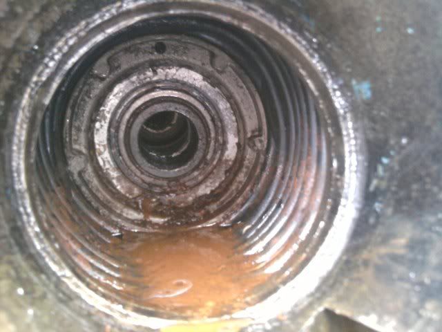

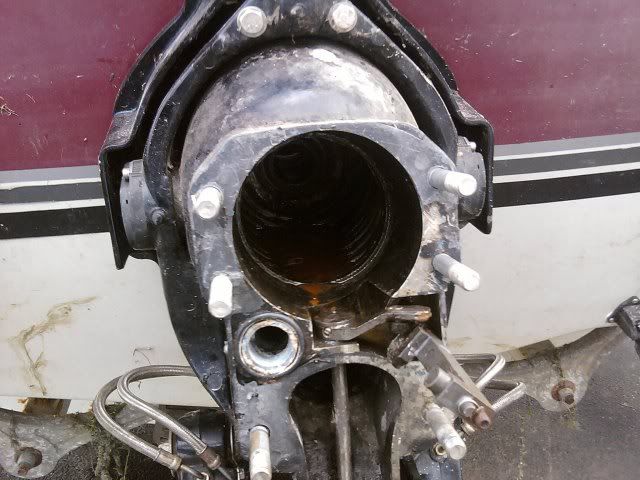

I got the drive off.
Yeapp, water shouldn't be in the U joint bellow and the exhaust bellow is in 3 pieces.

We put it in fwd gear afterwared to get the cable out a little further trying to figure out how it comes off to get the new bellow on. I didn't see it mentioned in the manual. Yea, anything "boat" is jacked in price and I already know sourcing my gaskets, bellows, o rings and such online will save me tons of money.
