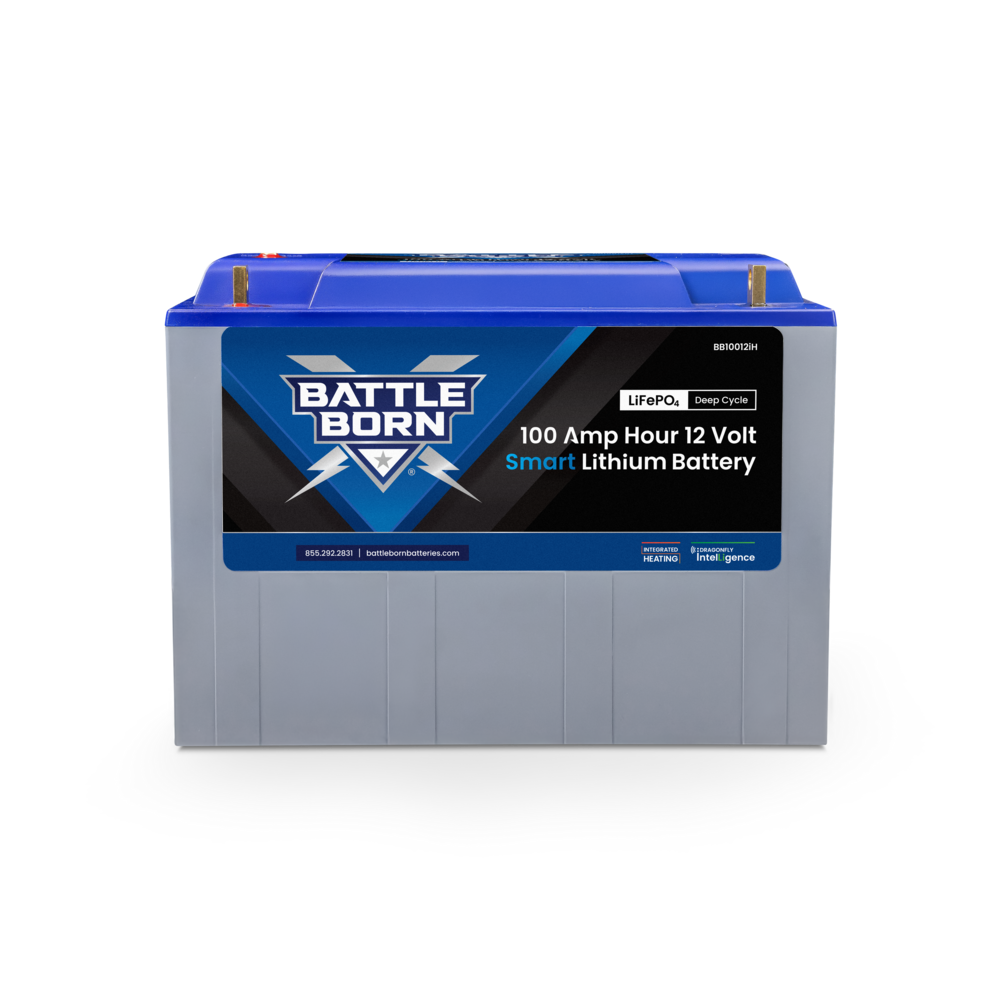

LiFePO4 is a Lithium Ion battery. There are many subtypes of lithiun Ion batteries....one of which is LiFePO4.
Go to the Battleborn battery site...one of the pioneers of drop in LiFePO4 batteries. The home page even calls them lithium Ion batteries.
