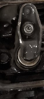

when you said: All the rocker nuts should go down the same amount; you meen 0 lash + 3/ or 27 nm?
In post 6 the pic shows some of the rocker nuts are not at about same position a the others, this is why I mentioned it
If not all had been torqued to 27nm then that also would be the reason
I'm wondering if some of the lifters are hanging up inside or on outside in the bores.
I wonder if you have a mix bag of parts?
How long are the push rods?
No now all lifter are out in oil tank. In the video i'm workin only on one lifter.
In the picture same, it was before to start to tight all i will make one picture after tight all at 27 nm but when i did the nuts look like same

As we all know something is wrong. The adjustable rocker will have self locking rocker nuts and you will not be able to tighten them with your fingers.
I bought this motor used and those are the bolt found inside. Do you think they are wrong? They are for sure not self locking . They have the not loosening part on botton (like washer) similar to the one in the picture
Is not right?

Alldodge good point on the self locking nuts. All of those should be replaced for the adjustment to hold.
:( didnt find any just 12 of this bolt found. But this is the only place where they could go

Online i can see this not like mine 😱😭

Yes that is a self locking type
Check the length of the push rods
