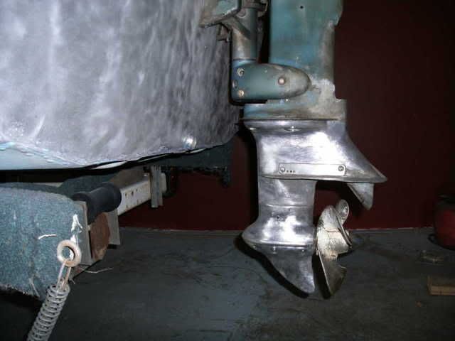

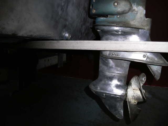

Jason, Just to let you know your not crazy, here some pics of my 18" short shafts :confused: on my Lone Star. The first two are an 18HP and the last is a 10HP. I had asked the same kind of question a couple months ago.
I still think your best solution is a jack plate. That way if you ever need or want a different motor you could look at short shafts.

AAAAAAhhhhhhhhhhh!!!!!!!!! I'm going crazy!!!!!!!:confused::mad:
Whew:) I started to froth at the mouth a little there. I feel better now.
Yup, your photos make total sense of what I got going on round my place, thanks!!!
