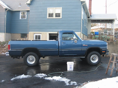

Like so:
Bought it a few weeks ago for $5.5k. Will pull the house over, gets 17 around town (low 20s on the highway) and has NO RUST! ;)
/threadcrap ;)

Re: Looking over new full-size trucks, finding only Class III hitches (5000lb max)
Like so:
/threadcrap ;)
Yup thats it.
