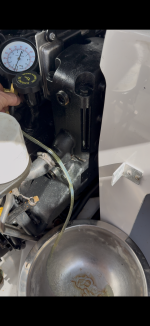

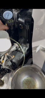

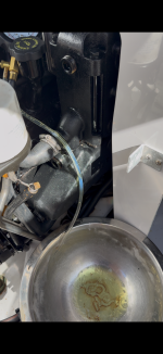

Hi All,
So, I ran some tests today.
Firstly changed the fuel filter to OEM 25 micron. No change in fuel pressure.
Secondly I disconnected the FP relay and ran a jumper over the terminals, this runs the pump without the key being on. Whilst pump running and key on (engine not running) I tested the voltage at the relay and got 12 volts with pump running and static pressure of around 40psi.
Thirdly I think I found the issue with the relay terminals which caused FP to shut off the other day. When the relay was connected the terminals weren’t touching properly so I slightly the bent the prongs on the relay so that when inserted it gets better connection. However this made no change to fuel pressure and still sits at 40psi when static and around 33 when running.
Fourthly when running I purged a bit of fuel out of the pressure gauge connected to the fuel rail, and from what I can see it appears there’s lots of air in the fuel?
I have taken a video of this and seen i can attach below.
The end result is that the fuel pressure issue is still not resolved. If it is air getting in, I don’t know where it would be entering because i pressure tested everything upstream of the fuel filter and there is no leak. And the mechanic said he also put a portable tank and connected it to the fuel filter which made no change in fuel pressure, so that leads me to believe there is no leak between fuel filter and boat tank.
Any further advice is appreciated.

Tristan1985
Dec 21, 2024
18
I couldn’t upload the video so uploaded some stills. You can just make out the air in the line.

alldodge
Mar 8, 2009
43,743
With motor off and pump running you get 40 psi, but when motor is running you get 30 psi, correct?
Any time fuel is released from gauge there is a lot of bubbles, correct?
I don't see an issue with lower voltage at the pump, your good there
