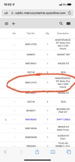

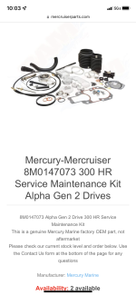

So I was looking up a part on Mercury’s parts website and went to the Maintenance Kits section for the alpha 1 gen II drives.
They have a 100 hour maintenance kit and 300 hour maintenance kit. The 300 hour maintenance kit includes the bellows, gimbal bearing, shift cable, anodes, and water pump. What’s that about?
Again, I trust what you guys are saying and looking at my bellows last night, they look great, so I’m not messing with it. To be the devils advocate, I guess I wonder why, if Mercury doesn’t recommend replacing that stuff at certain intervals (just inspect and R&R if needed), why do they sell a kit that replaces that stuff at a certain interval?

IMHO, 300 hours is a nonsensical number. Only by using average boat hours of use per year, which is well under 50 hrs/year if I remember right, can you use a fixed hour for maintenance on stuff like bellows and lower shift cable. That puts replacement in the 7-10 year range. Even then it is a true WAG. Is the boat in the water all the time? Is it in salt? Acidic water. Stored in the sun with the drive up? And so on.
True. Seems like all my toy’s maintenance schedules are by hours but it’s just easier to do things annually and most of it is inspect and replace when needed. I created checklists for everything I need to inspect. I’ll have to re-do my boat checklist to include inspections of other items now that I didn’t think of before.
Fluids get changed annually or every 2 years depending on item & fluid. Only maintenance I do per hours is my tractor which gets used heavily throughout the year.

Look in the service manual, it says 300 hours or 3 years (whichever occurs first)....
But yes, Rick said it in one word, money. Sounds like you're on the right track with 'inspect regularly'... (Wish more people did that)
Chris...

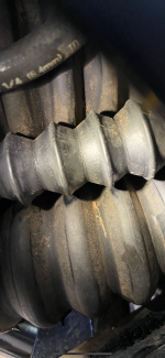

A looked at my bellows today and they seem in good condition. Still flexible with no cracks.
My shift bellows does have some signs of dry rot in the folds. And the metal clip is pretty rusted. Still ok or change shift bellows?

Pull that rusty clamp off and put a cable tie in its place.

Dont worry about the metal clip, mine rusted away completely- you can put a zip tie on it.
What I cant see much of is the driveshaft bellows. I just changed mine (2004 lift kept fresh water boat) they started to get abrasions by where it contacts the hinge pins and gimbal ring. The old ones were much stiffer than the new ones , exhaust bellows ripped two years prior.
You're on the right track observe and replace. do your annual oil and drive lube changes hit the grease points and watch the rest.
