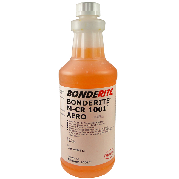

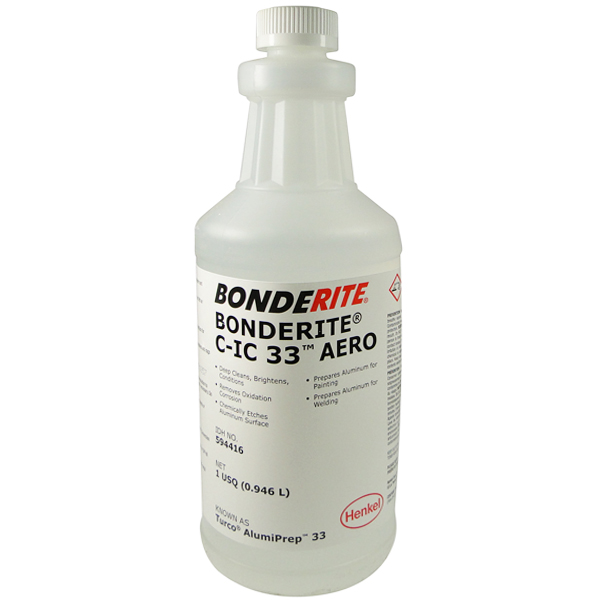

Ok here we go. But first..
Question: would you read these manufacture instructions as applying Bonderite M-CR 1001 (print prep) to a wet surface of Bonderite C-IC 33 (aluminum cleaner)? Seems odd
THE PROCESS (According to tech bulletin below)
The process to prepare metal for painting normally consists of the following steps:
A. Cleaning (Bonderite C-IC 33)
B. Water rinsing
C. Apply BONDERITE M-CR 1001 AERO
D. Water rinsing
Technical Process Bulletins:
Scott06
Apr 20, 2014
7,418
B. Water rinsing
D. Water rinsing
No you rinse with water in between any residual water is no different than the water you are diluting the Alodine with. Prob biggest key if spraying is to keep it wet for process time. Then don’t let it dry before rinsing
