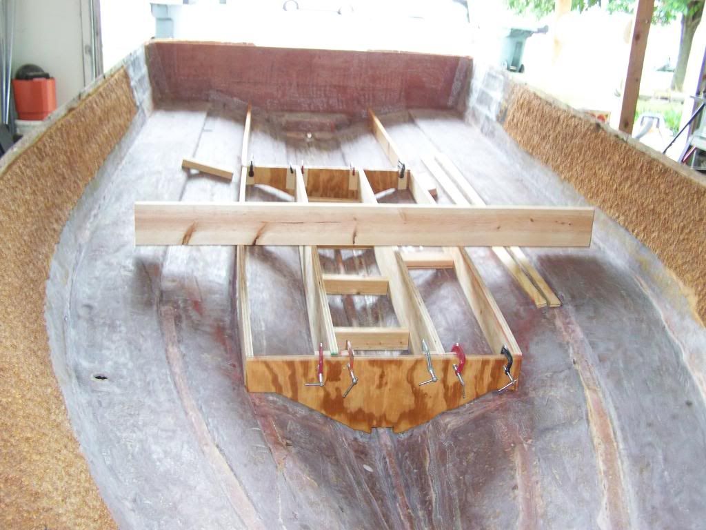

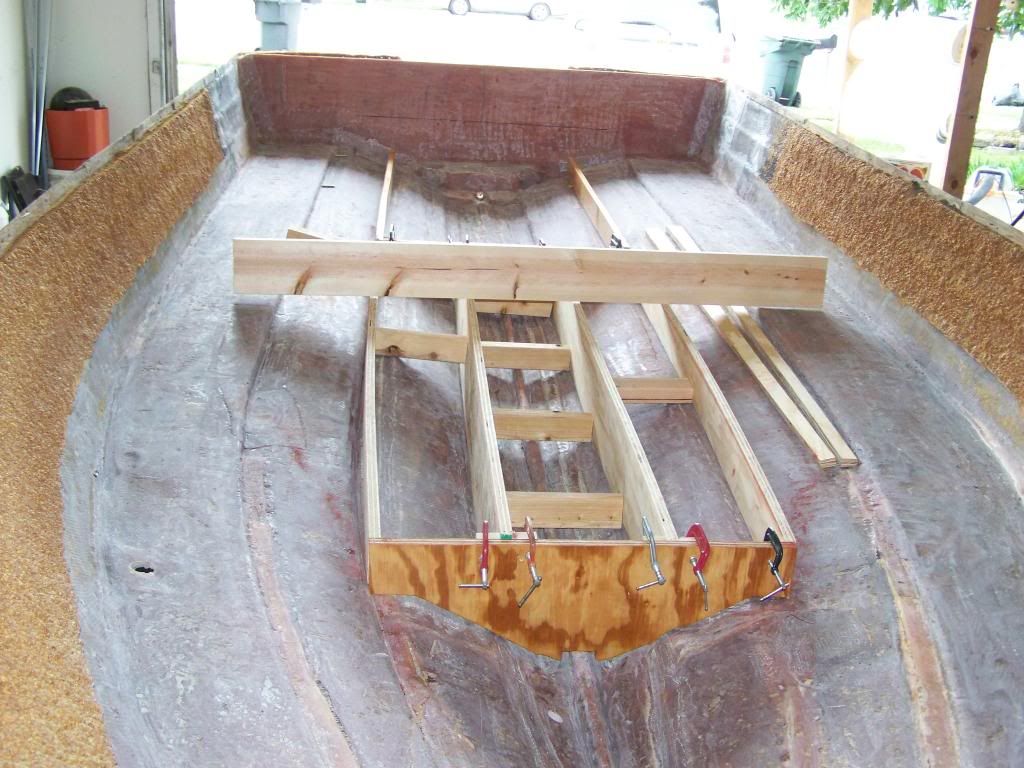

I need help if any one can... I about to burn the damn thing to the ground all because the stringers don't want to cooperate. I know It can not be as hard as I am making it, but for what ever reason I can not get them right.
So heres the deal. I have a total of 6 stingers in the middle of the boat. I know that the floor lays on the outside of the hull on both sides. So I did the ol pen and stick method to get the line of the boat on the bottom. I cut the stringer bottoms layed them in there they all fit great. they matched the lines awesome. So then I went to get the height of the stringers. I know that the bulkheads match where the floor should go. I believe they are 100% on. I put a level on them and the are completly level.
So I snap a chalk line from one bulkhead to the other.Thinking that will give me perfect height. Here is what that looked like.
You can see that both sides fit flush to the side. As I move the board further to the front of the boat the more and more it becomes further and further off the side of the hull.
and in this one it will only match on the outside. There will be little pieces of wood that will close the gap on the ends.
So long story short. Is there a proper way to measure stringer height? Because I am not doing it correctly.

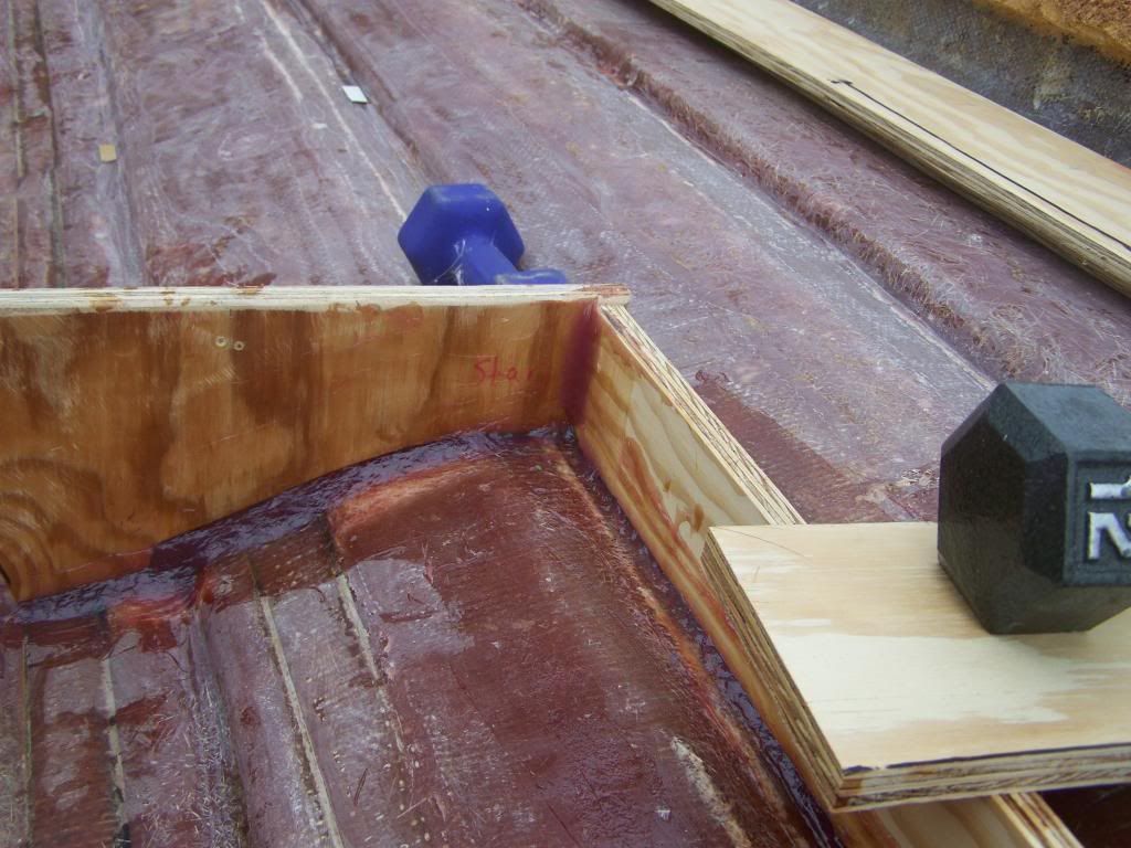

First the drain hole. We talked about its horrible location, and discussed moving so I did that. I filled all 3 holes then drilled a bigger hole in the middle and a little lower. Now this did cause some issues. First the middle stringer. It went all the back so I trimmed that and I put the two blocks of plywood on the sides so I had to trim that. Heres the completed project.
I thought that turned out pretty good nearly level and now I can glass and direct the water where wanted.

So then I fought with all the stringers in the middle section and posted above. I could get them level on both ends but never in the middle. So After making the post above, I just slowed down. I took a measurement every inch and then made a pattern. Cut it and walah. That took way to much time and the stringers them self cost me over $100 in wasted wood. That really hurt. But I rushed and paid the price. The pics are above that are close to what they look like now they just dip a little in the middle so no new pics.
