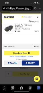

Maybe not even the problem but I keep an extra one of these and some zinc thermal paste in the glovebox just in case.
I was my 1996 Impala ..... I was the ICM and the coil ignition ... fixed it of the thermal paste ... I was the liquid paste of the coil ignition ... did a very good job .... nov 1995 - todays engine ...
