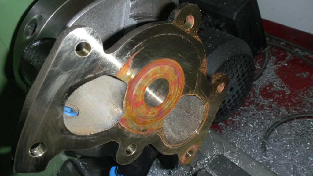

The brass water pump housing is a complete disaster from Mercruisers stand point. Even the smallest grooves on the back plate and in the house with not allow the pump to prime after fitting a new impeller.
There are kits that can be purchased that use ware plates, or you can machine the back plate and buy a new front housing. I bet you have not done anything wrong at your end...........................it's just a common problem with that style pump.

Boat sits on a lift and I'm running it on muffs (yes they leak pretty bad)... I have read about the wear plates, I'll probably going to buy the rebuild kits form JCmarine

Problem solved... The housing was scored so I used the Kit from JC marine (Captain's Choice in Ft. Walton Beach had a few in stock) and everything started working again. Now that I know what I know I can do the other engine. Thanks for all the help.
