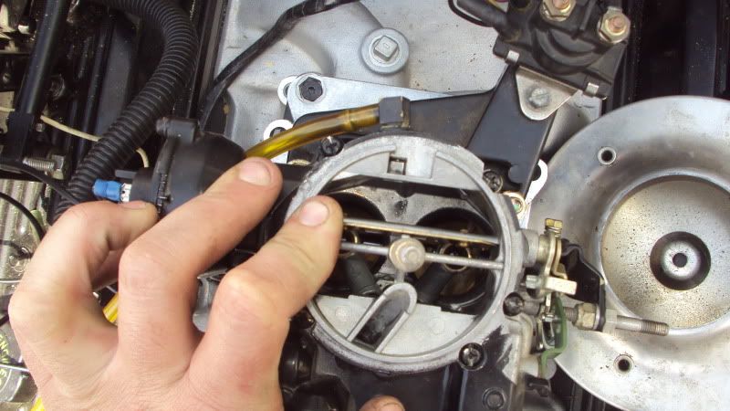

Fresh rebuilt Merc 5.7L Thunderbolt V wont stay running longer than 5 seconds or so. Tried feeding it gas through carb and still dies.
New mechanical fuel pump, no gas in sight tube
New fuel filter
Siphon valve cleaned
Fresh Gas
New coil
Carburetor rebuilt (Mercarb) Venturies were real dirty and had a lot gunk under the venturi cluster. Bowl had a lot of junk too. Stem works up and down smoothly, new power valve, needle and seat (spring type), cleaned metering jets, new acc. pump, new check ball and spring for the acc. pump "check valve". Used carb cleaner and compressed air. All passages clear.
Reused old float and set level to 11/32" and float drop to 15/16". New float they sent did not have the measuring dots on it so I didnt even attempt to mess with it. New idle mix screw, screwed all the way in and backed out 1 1/2 turns.

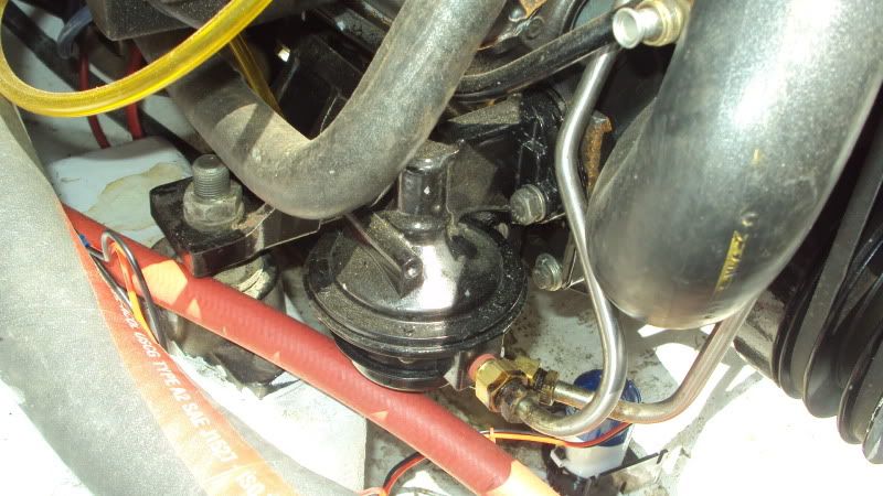

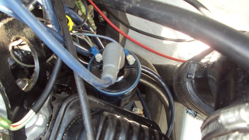

Do you have spark immediately after it dies? How long after it dies can you start it again.
Hook a jumper wire from the positive battery terminal to the + terminal of the coil and see if that keeps it running.

The yellow tube that runs from the fuel pump to the carburetor. I have a mechanical fuel pump. I installed it.

Sometimes takes a little while to crank again. Will try the jumper.

Cut those push on/spade terminals off those coil wires and put on some ring terminals and use the nut to hold them on securely. :facepalm:
And disconnect the gray wire from the tachometer if it dies with the jumper wire.

There are no studs. I wish it did as that would be best practice.

Gee. I wonder if you would still have this problem with the correct coil installed? Just thinking out loud.

Because it doesnt have studs or because its not rated to fire 8 spark plugs? Is there really that much difference between the one I got at NAPA and the one mercury says I should have? Does the NAPA coil only output 10kV and my motor needs 30kV to run correctly?
I dont mind buying a mercury coil, if its actually something worth trying. To me its all apples to apples, but Im probably wrong.

Were the NAPA coils marine coils? And were they designed for Thunderbolt ignition? I just put new coils in my Thunderbolt IV, and on the side of the coils I purchased they said something about using an external resistor (or not using it I don't recall)....
But it seems that regular auto coils and non thunderbolt coils are different from Thunderbolt WRT this resistor, That could be your problem. I read a post from a while back talking about having issues w/ non thunderbolt coils.

IDK if the coil is your problem, but Occam's Razor says the simplest solution is usually the correct one. Eliminate it as a source of problems and then you can narrow it down better. A new coil is only $35.00

New coil was $72, will be here next week. We will know soon enough. Thermal breakdown would make sense with this issue, as the engine runs the improper coil builds up heat and cuts out, once cool it works again.
