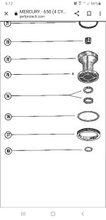

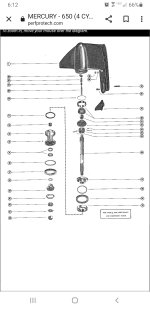

I have a 1970 merc 650 4cyl. I'm trying to replace the prop shaft bearing carrier oil and water seals. Is there any way to do it without removing the bearing carrier assy? I attached 2 pics of the diagram for the lower. #74 is the seals im trying to replace.

There are tools that can extract Seals in place. They kind of look like a piece of Threaded Pipe, fit over the propshaft and then turned, The Threads bite into the seal and then it can be pulled out. Don't go trying to use a piece of Iron Pipe, as it is too rough inside and will damage the Propshaft sealing surface
Some people will drill a couple of small hole in the Seal, then screw in a couple of screws to grab on. Again there are Risks at damaging the Propshaft.
It is safer, just to remove the Carrier

Right on, any tips for removing the Carrier? I don't have a manual But I do have a shop full of tools. I've done that trick with the screws and drilling into the seal but only on larger lip Seals... seems risky on such a small one...guess I just have to pull the Carrier and do it right
39,503
On a fresh water motor you bend one tab on the lock washer then remove the big nut.----Slide hammer and a hook to pull carrier out.

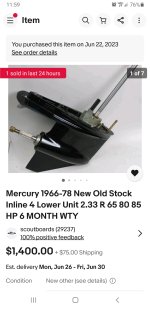

Easiest and likely least costly, is to find a Lower Unit, from a 4 cylinder 75, 80, 85hp. The 79 and later have slightly more Hydrodynamic shape.

Thank you jimbo.The search is over! Cost me a few shillings but hopefully I can sell my complete 50hp and 6cyl lower to make up for it...I can't believe I found a new old stock complete lower unit and from what seems like a reliable seller! With a 6 month warranty! Thank you to everyone who's helped, I really didn't look before I leaped into this, but I've learned a lot and now I'm closer than ever. Back to deciding where to start with prop size 🤔

Before you install it, replace the Water Pump Impeller. If it has been sitting 45+ yrs, I wouldn't trust it.
