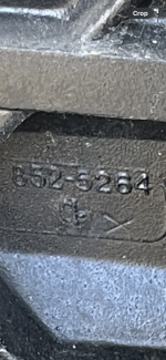

I noticed the block has an “X” stamped just under the part number on the block, but can only really seem to find reference to the J blocks online. Is there anywhere that has reference to these letter stamps? Wondering what the X stands for and what others there are?

Pull a transer port cover as that block casting is used on the non ported 115
So does mine.
So, according to an earlier entry in this convo, this number was only used for the 1500 in '74. My motor also has cowling saying '1500' and '150HP', but the previous owner says he bought those to replace the original '1150' and '115HP' ones that were quite deteriorated, I'm now confused, but often happens.

Another thing that strikes me, seeing OP's photos of the block of the motor... There is a serial number chiselled into the block where it says: 'SER NO".
No matter how hard I look at mine can I see anything that would even make a dip in the paint in that spot...
Have I bought a counterfeit copy of a 50 year old motor?
Yours is a replacement block. They won’t have a serial number stamped. Did find something about that on other forum and site searches myself.
