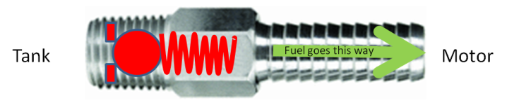

Antisiphon valve

There has to be one
Maybe there is a pickup tube and it is cracked and is intermittently sucking air.
What is the function of the anti-siphon check valve? To prevent the fuel from flowing back to the tank? If so, maybe it is defective and gravity is causing the fuel to flow back to the tank.
It has 2 functions but the first iss for safety. It keeps fuel from being able to siphon fuel from the tank if a fuel line breaks. The other side it should keep fuel from going back to the tank, but then again the fuel pup should help in that effort
Thanks for the explanation! (y)
