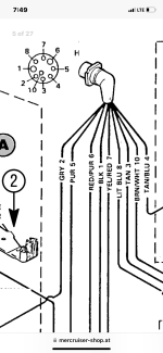

The fuel pump working well as is the carb, lots of gas flowing. I started looking at the electrical and with the key turned on (and all gauges/lights working) have no voltage across the return purple wire to ignition components (i.e. nothing to the ignition coil, the electric choke, alternator etc.. ), it’ll turn over but no spark. I can confirm 12v across the safety lanyard but downstream nothing, I checked main connection at the back, looks clean and tight, open to any suggestions- thanks!

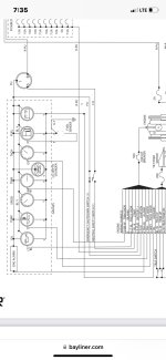

macdonda
Sep 9, 2023
9
Another drawing, I don’t have voltage across the purple to ground on anything coming back

ROY WILLIAMS
Aug 8, 2022
455
the emergency switch of the ignition components ..
starter the engine ... then the no running . the distributor is no spark ..
did the ignition fuse / emergency switch .. did the corrosion of the lugs/fuses ...
macdonda
Sep 9, 2023
9
No spark at distributor but no voltage to any of the ignition components, I checked the lugs, no corrosion, one of the 7.5A fuses is discoloured hard to see if it’s bad but I’ll replace tomorrow l, from what I can see though there’s no fuses for any of the ignition components (purple wires)

nola mike
Apr 22, 2009
5,786
So you don't have any power to #5 on the female side of the plug, but do at the gauges? Find the common point of your purple wire under the helm. They daisy chain off the gauges and eventually one goes from the helm to the cannon plug in the stern. Would be strange that you had spark before, rebuilt carb, and now no spark. But of course not impossible.
macdonda
Sep 9, 2023
9
I should have said I assumed spark it did start up eventually before but took many, many tries but agree - to go from some spark to none is odd
