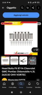

Can someone suggest me also where to buy nee head bolts? I sow this online but is for car and they ask car type :) are same? Do you know this seller? Have you got any other place where i can buy and theu would send to italy?

thanks, they are car spare parts, wich model i have to look at? i try on jegs but model is 96-2014 ( i think they are little bit longer from description also if i think there was not difference
for the thread i was thinkig to pass the thread maked in all thread before assembling,
what u think?

What I did was use a vehicle model that this same engine came in, mine's a 1988 V6, so I used a 1988 Chevrolet Blazer S-10 to find the right ones.
I like using a thread chaser, it is a safe way to really clean the threads, you can find thread chasers on Amazon.
If you can figure out which age range your engine is, that will help. The way to tell is to find the casting #, then it can be looked up on the net. Here's a few pix to show you....4.3L casting numbers & serial number.jpg

thanks. on jegs they have this, they mention 1996 ( my should be 1995 ) but should be same he said should be same

what about torque on this? the problem is that the size is not perfectelly same, mercruiser has 3" +1,750+3.750 ( thy are 1,5-2mm longher and one 2.2 mm shorter) what do you think? 1736540683579.png

remember yours is a Pre-Vortec, the Vortec started in '96, so make sure they know that, the bolts could be different as well as the torque specs.

what about torque on this? the problem is that the size is not perfectelly same, mercruiser has 3" +1,750+3.750 ( thy are 1,5-2mm longher and one 2.2 mm shorter) what do you think? View attachment 404776
Regular head bolts will stretch under torque and this is why there are different torque requirements for different lengths of bolts. ARP are much harder and for the most part will not stretch under load.
Just using numbers off top of my head
Merc says torque in 3 steps to 125 Ft Lb
ARP says torque in 3 steps to 70 Ft Lb
If you torque the ARP bolts to 125 you just might pull the threads right out of the block. My bud and I did this very thing on a 454 rebuild. It came with the sheet telling us what to do and we said we don't need to stinking instructions, we have the manual.
this is if i put chery S10 that was manufactured in 1995 ( should have the 262 block)

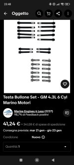

Perfect i eill buy new then. The problem is that in italy is not so easy.
You know this company?
Sorry don't know the company, but the main thing is that the threads are nice and clean. As long as they thread in well, they should be OK. Make sure to follow the torque spec pattern, etc. Since some of the bolts bottom out in a cooling passage, I used Permatex Aviation on the threads on mine.
Those look like they already have sealer on them, the ARP ones come with a tube of sealer you put on the threads.
