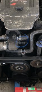

Assume that’s the temp sensor right?

The sensor in your photo is the temperature reading for the ECM… Though can’t see it there should be another sensor on the other side of the housing with one wires attached (Tan) that’s used to read the temperature gauge.
Be sure the engine is truly getting up to temperature of 160 degrees because if the thermostat is broken/stuck open the gauge would read really low to where it looks like the gauge is broken.
