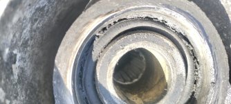

Got home and looked at the Michigan Wheel prop. It's an SMC378. Discovered some dry rot starting under the grease:
Maybe not so good after all...
The Solas prop actually is a 19 pitch 4 bladed prop. Specifically a 1513-143-19. A bit smaller in diameter though (14.25) but being 4 bladed makes up for it?
Choices, choices, choices... Thoughts on which one to try next?
