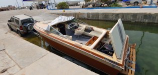

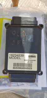

Hello to everyone,
New to this forum, proud owner of a Chris Craft Scorpion 210 with a mercruiser 350. After testing, I was told by my mechanic that I need a new ECM (motor is a MCM 5.7L EFI). He replaced my original ecm (delco model 16234539) with another he had in his shop (delco model 16189069) just to have it in the water during the summer. Unfortunately the engine won't rev past 2500 rpm and the boat isn't useable.
With some research that I have done, only used ones can be found on eBay. My question for you experts is will a same model ecm be compatible with my engine? Are there any other options available (re program the original)?
Attached pictures of my engine and ecm.
Many thanks in advance and Merry Christmas to us all!
Kostas

Thanks for the serial number, your ECM is a MEFI-1
I'm finding the 16234539 (you old one) is for a 454 TBI
The 16189069 is for a 5.7 TBI
There was 3 different mefi units for the serial number range
Flat tapped motor
Roller cam motor
LX motor
Using the other mefi and only getting 2500 rpm would need to start with the basics first.

Alldodge thank you for your answer.
From what I can understand you're suggesting that the engine had an incorrect ecm installed. I cannot argue with this, as I purchased the boat/engine after 15-20 years of storage.
Attached a printscreen of the ecm listed on mercury marine parts catalog (part numbers 807650t2, 861078t1, 806720t7) for my serial number. Do you know which delco ecm is it?
I have checked plugs, compression and firing order, replaced distributor with a new one. I don't know what cap and rotor means!

cap and rotor is distributor cap and rotor is the rotor button under the cap. You replaced the distributor so will assume the cap and rotor was also replaced
https://www.mercruiserparts.com/808483t3-cap-distributor
If the boat is a 1996 or 97 I would think it should be 861078T1 for the roller cam. Maybe @achris could look up your serial number and verify
Timing is set by putting the motor in base timing mode (BTM). BTM is done by using a jumper or paper clip connected to pins A and B on the DLC connector (pic above). With motor idling at spec, adjust timing

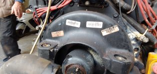

Thank you all for the comments.
Dear Chris,
Don't have the serial number you ask, but will go and check it out tomorrow. Only found the attached picture that I took prior washing the engine.
Bought the boat/engine 2 years ago, had the whole thing taken apart for restoration, I worked on the boat and took the engine assembly to a friend mechanic. He replaced oil filter, oil, spark plugs, gas pump, both throttle body injectors, etc and finally got the engine running. When the boat was finished we had the engine installed and tested in the water. Unfortunately the engine couldn't rev full rpm and due to the boat's weight no travelling was possible. He then replaced the ecm with another (as stated in my first post) worked better (max rev 3200 though) and was able to stay afloat the sea level (please excuse my bad English). Unfortunately it only last one ride, then same problem happened again. Haven't been able to sort it out since.

If you find the block casting number it can be looked up at mortec.com
