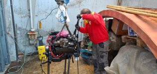

Just a good wash was enough for the old layer of wax to be removed. The engine only has 235 hours since new...

No, this is not the original to the boat engine. The boat is 1984, the previous owner replaced only the engine (Mercruiser 225hp) around 1997-1998 with this new one (left the original alpha one sterndrive).
I'm wondering whether the pressure washing is the cause of the problem I have!

Which is why I wanted to see the intake manifold...smiles its all telling. Now that you bring up this new engine..the serial number is quite relevant. It is eye opening to see how European country's approach US made boats and Rv's. Lots of hands on fabrications...
A question is that stern drive a left or right hand rotation?
