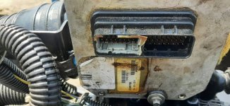

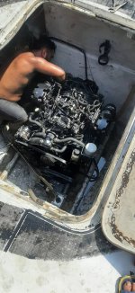

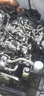

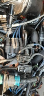

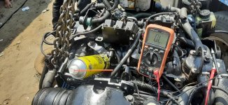

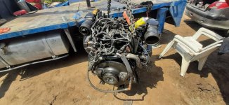

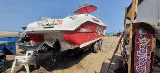

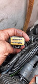

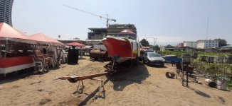

Hello friends, we also have this problem that the engine revs up to 4,500, 5,000 when stationary, but it does not increase to 2,000 while moving, and the oil pressure is not constant and it plays constantly.

More pic
